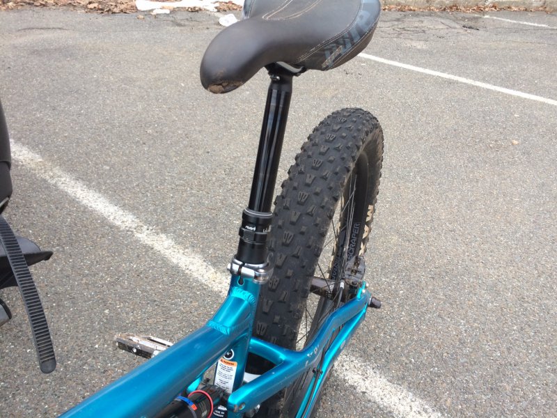

Last weekend while out riding, my Rockshox Reverb Stealth sh!t the bed or more accurately pissed the inside of the seat tube. It was more a pogo stick than a seatpost during the ride. At first I was just going to send it out and have it rebuilt, but based on the availability of the rebuild kit and the online video instructions, I decided to give it a go. I stripped it down, swapped out all the O-rings and replaceable wear parts.

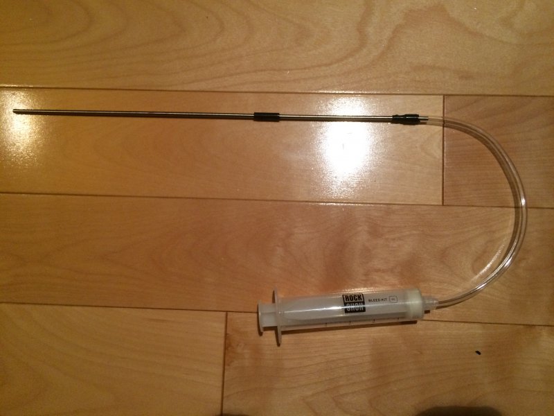

There was a level gauge used to set the proper amount of hydraulic fluid in the post that doesn’t seems to be sold anywhere so I hacked one together.
After reassembling the post and reinstalling it, everything seems to be operational. Got it out on the trail today and all seems good.
Overall it was not a terribly difficult item to rebuild. Just a lot of small parts to be replaced. I probably spent more that I should have as a result of buying some of the tools needed.

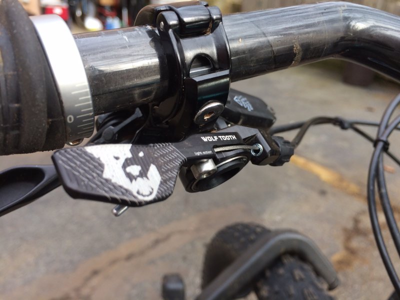

One other note – I had replaced the hydraulic lever with a Wolftooth Remote Sustain mechanical lever some months ago. This made it much easier to remove and reinstall the seatpost. Operationally, the lever is more ergonomic and works well with the seatpost.

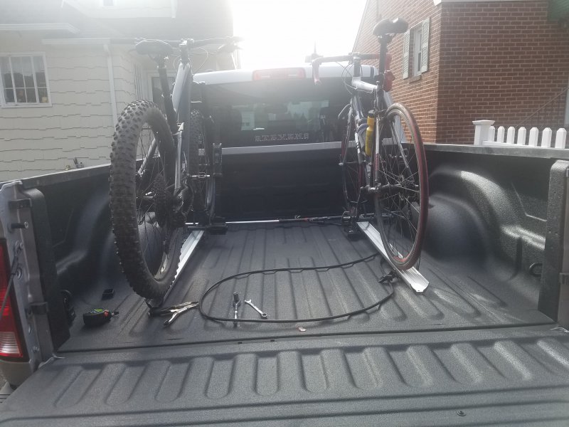

that works - how are you holding down the rear of the trays?
They seem pretty stable just attached to a piece of 2x4 for balance and sitting on the bed for now if I have a problem with that I'll get another tension bar to put at the back
yea the 6.5 ft bed was a requirement when i bought it for just this reason. I dont think an 8ft bed would fit in the driveway too easily. . . at least not with 4 doors.
fortunately i didnt have to make that decision as noone offers a 1/2 ton with 4 door and a 8ft bed anymore

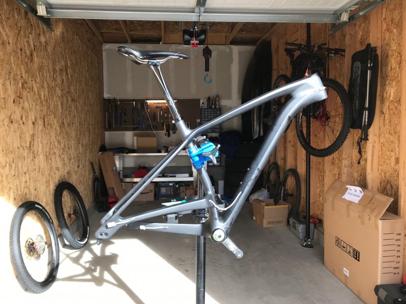

I started putting together a new bike this weekend. Is going to be a bikepacking/touring bike. Got off a several hiccups but I made some progress.
The frame is a Stache knock-off:
I'm going to try a carbon split seat-tube seatpost to try and get a little suspension to help the 29+ rear tire eat the road chatter.

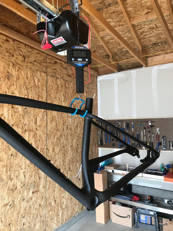

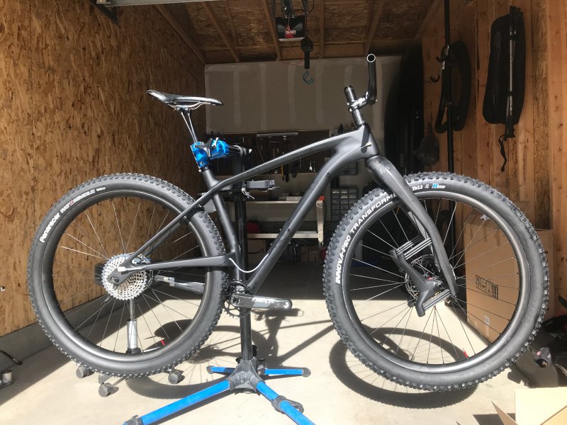

A little progress today with La Mula (the mule :)).

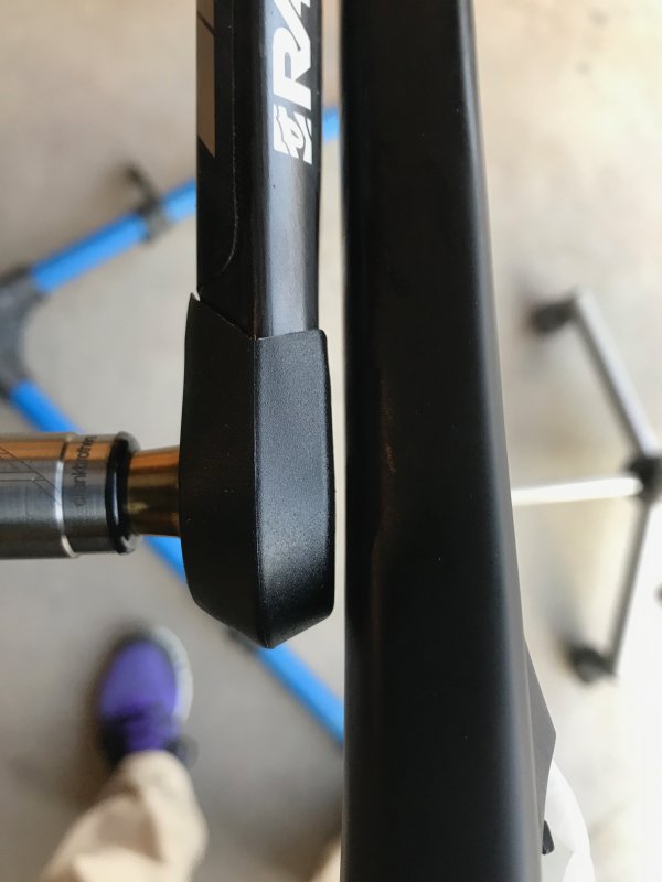

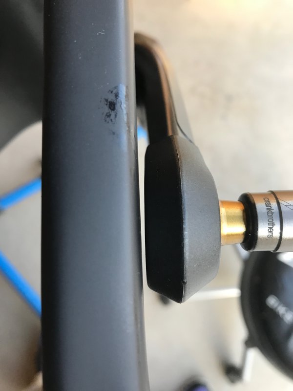

I re-installed the crankset. I had to remove all spacers on the non-drive side. The clearance is minimal and I think if I were to stand up on a hill with a loaded bike (high torque situation) the cranks will rub the chainstays. The other thing is that I don't think I'll be able to put the Garmin cadence sensor, which is a bummer because especially in this bike I wanted to control that I stay at high cadence to help me with endurance rides.

I also cut the steering tube (first cut anyway). I'm going to have a long piece of steering tube between the head tube and the stem. I knew this though. Part is because of the for I'm using (less crown to axle distance that the recommended fork for the frame), and part because I want a relatively high handlebar to have a more comfortable position for long rides (a bit more upright position, less weight/stress on hands & arms).
When I tried to install the shifter I realized they put the cable guide for it through the wrong whole on the frame (on the drive side), so I'll have to see if I can thread that guide right. I've hated this part on other frames so not looking forward to this. I also realized that the rear brake hose is supposed to run internal to the frame. Is this common now? This threw another monkey wrench for me. I've shortened brake hoses one time before and was able to do it w/o bleeding the brakes, just holding it up while I cut and re-assembled the brake lever. If I have to thread the hose, I'm guessing I'll have to bleed the brake hose dry.
Today (before cutting steering tube). I can't wait to try the big wheels and tires!
