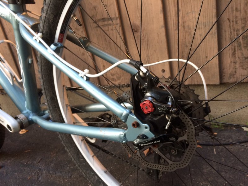

that sounds like the $185 Therapy (http://www.therapycomponents.com/disc-conversion.html) adapter.
While I was looking for a link for that, I stumbled across this (http://campusbicycle.com/product/trek-international-disc-brake-mount-154274-1.htm), ordered one. For $28 it's worth a shot[/QUOTE]
Don't think it was the Therapy, but was similar in as much as it stretched down most of the whole length of one seat stay. From a quick search, think it might have been the "shark fin" adapter that Specialized offered as an aftermarket purchase, seen here in this image: http://www.retrobike.co.uk/forum/viewtopic.php?f=1&t=343952
That said, was a used frame and it came on it when I bought it so wasn't sure who manufactured or sold it. At any rate, good luck with the adapter you picked up.

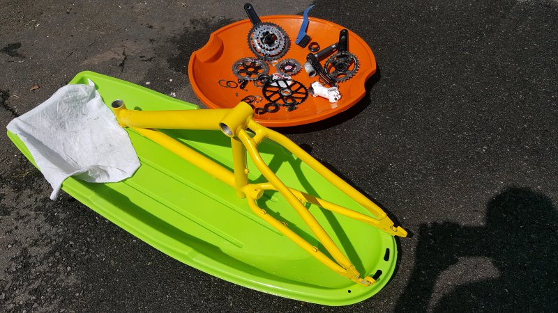

I turned this:
into this:
And then took it out for it's first shakedown ride this morning:
Very nice ride ... smooth, and above all QUIET!!!

I turned this:
into this:
