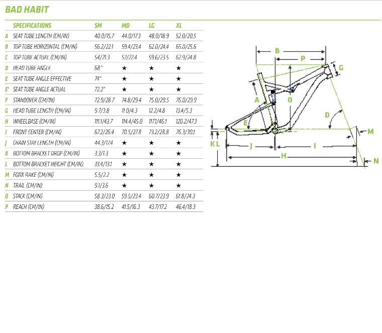

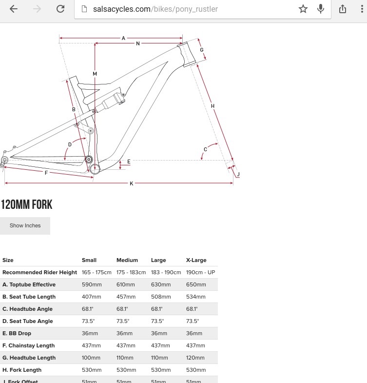

Some random thoughts after poking around.
Salsa has iscg05 tabs, so will be able to mount a bash guard. Would prefer Shimano brakes. Has split pivot rear. Can use 2x crankset. Has boost 148 rear. Short chain stays.
Spesh gets dinked for low bottom bracket complaints, (happened to me on a test ride) Also rims on narrow side, and non boost 148 rear, with horst link.
C-dale is out for me due to lefty fork has short steer tube, and do not want to mess with stems. Been there, not doing again.
Also non boost 148.
Scott is a close second, I like the 2.8 tires. Has boost 148 rear. Rear suspension, would prefer split pivot or horst link.

I will be meeting with salsa again shortly, confirm the size and model and I will make a push for allocation on one. I have already been told no, but it has worked before if I tell them it is a sold unit.
I think you are after an xl. The head tube is varied in the new bikes and the c-dale is actually longer.
