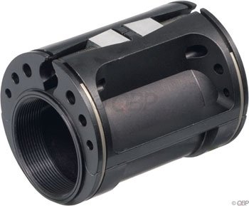

Options to replace Niner Biocentric II EBB?

I have two bikes with the Niner EBB. ROS 9 and a SIR 9. EBB is both in the 7 oclock position. Maybe because its steel I have never had a issue with slipping. I do exactly what Niner says, clean it real good, no grease and torque it down to 12nm.
Thanks, I checked yesterday and mine are also 7:00 on the ND side.
