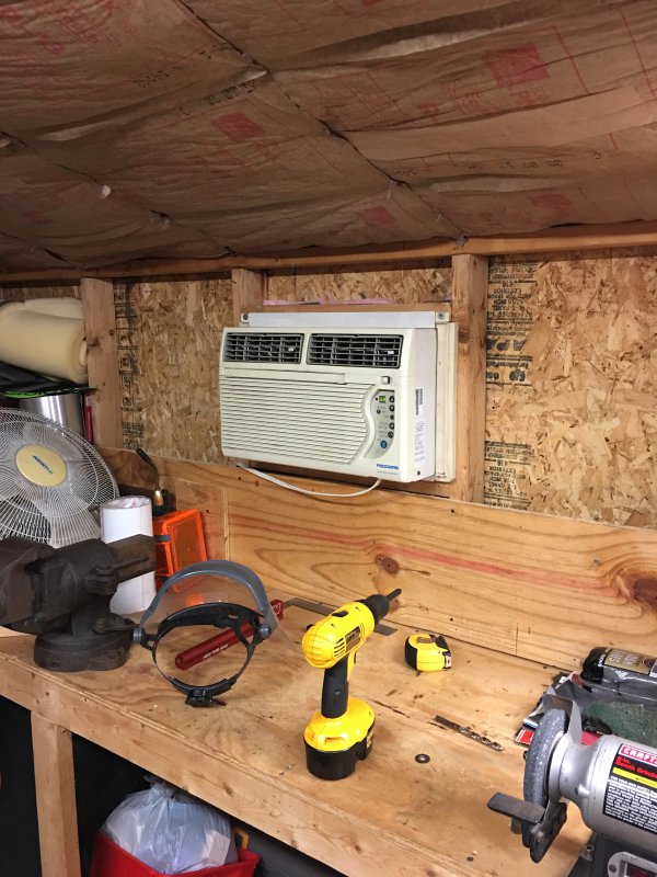

A little bit of cleaning, rearranging, and most important... an AC unit!
RobD
Active Member
That's one thing my garage workshop is gonna need. No windows tho - gonna need one of those free standing units
I cut a square in the back wall just big enough for the window unit and framed it with 2x4's then packed the small space with insulation before I slid the unit all the way in place. Finished it off with spray foam in the small gap on the outside. I'll be making and insulated box to go over the outside of the unit for winter. Only thing left to do is insulate the walls then finishing the walls and ceiling with 1/4" plywood and a black & white checkered vinyl tile floor.

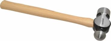

or hammer - not sure a ball peen is the right choice, i'd go more shawshank redemption.
