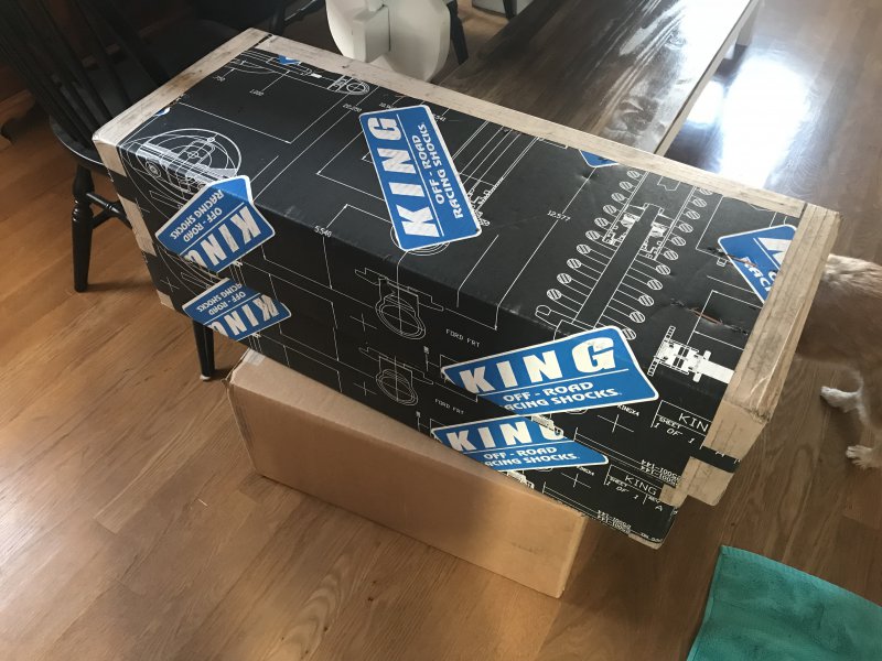

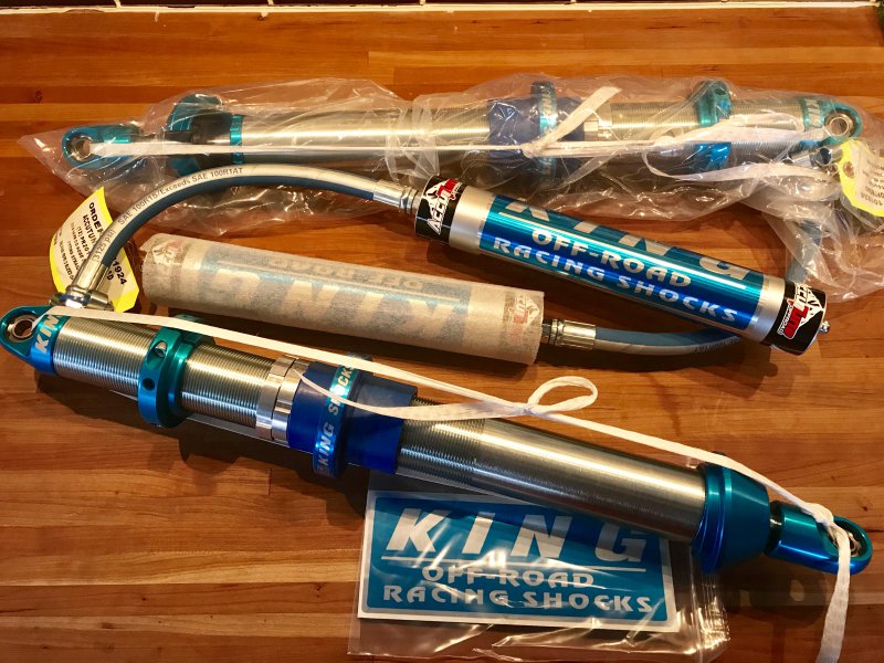

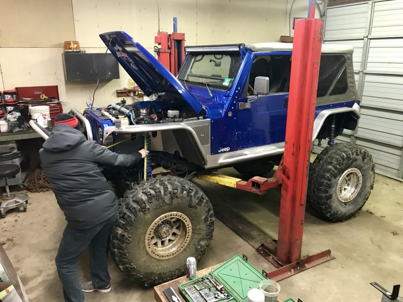

Moab prep....taking measurements for my new coil overs I am having built prior to Moab for Easter Jeep Safari. They should be on in the next three weeks.
Oh Fatboy, how I love thee. I am shooting for 4500 miles this year and still in line.
Leftymuk

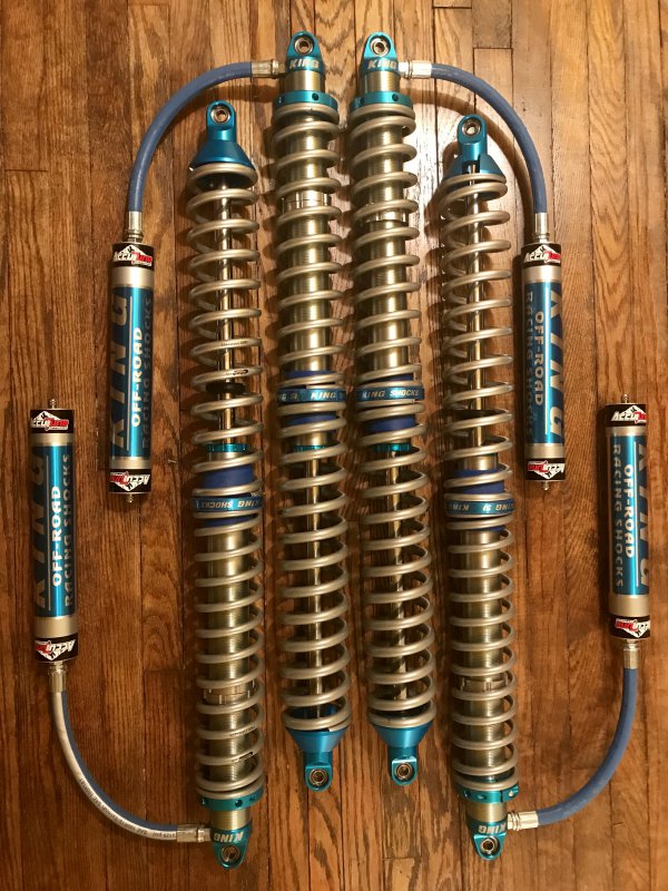

what....no helper spring...did they come from Genright? If not who did you have valve them? spring rates?
Johnny Utah
They were built and valved by Accutune Off-road in CA based off the corner weight on each end. They are dual rate coils, a 14” and 16” spring on each shock with different spring weights per axle. These are 2” body with 14” of travel.
The preload is set on these in the lower picture.
Genright does a nice job, but the ones in stock are a “three tunes to choose fit the masses” type of thing. King sets the tunes for Tony to my knowledge, but they can rebuild in house at Genright.
Accutune can build anything from mild to wild, but they have built many of my buddies shocks from daily drivers to KOH rigs.

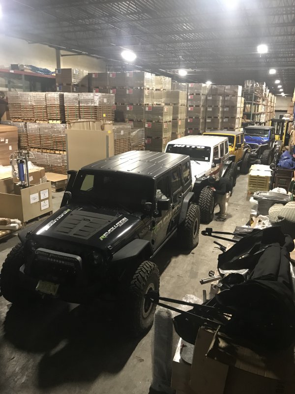

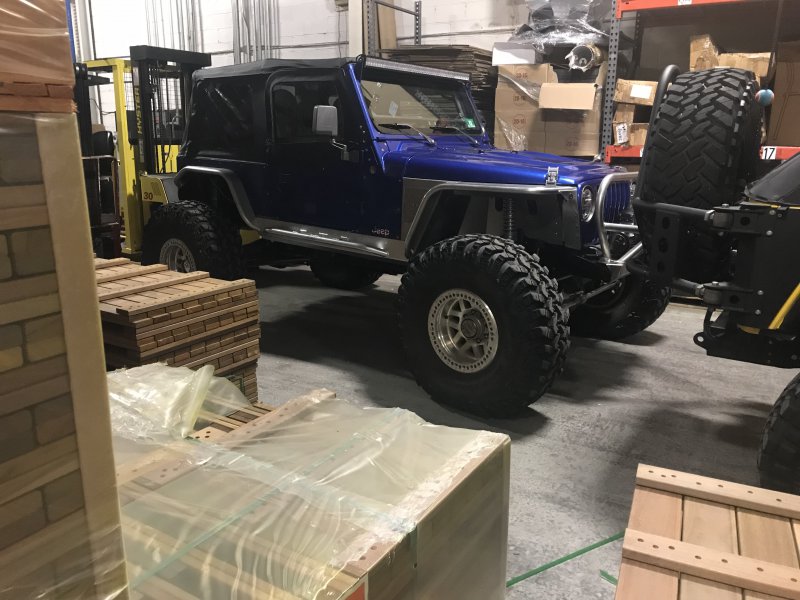

Dropped the Jeeps off at the shipping agent this am. Spent the week loading everything, prepping, greasing and stocking up on extra parts. Flying into Denver Friday then driving to Moab to meet the Jeeps.
I fully plan on dressing like Alan from the hangover for the flight....because I finally will have minimal chance of running into a customer from work.
I should gain a solid ten pounds next week.....
In addition we just redid my buddies JK steering and added a winch....it’s been a crazy three weeks of wrenching.
Some of the days will be beyond my 19 gallon fuel capacity so I added extra tanks to make up the difference. All packed without driver I am right around 5300lbs. That includes spare front and rear driveshafts, every needed to disassemble/reassemble (for the most part) lots of spare fluids and recovery gear.
