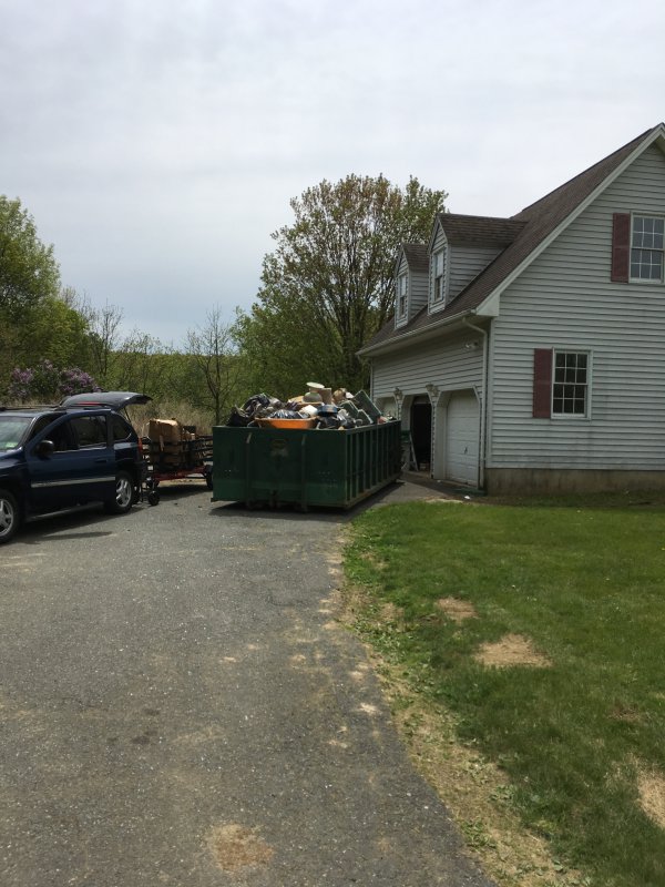

NICE!!! At first we thought bulk pickup would take all of it but NOPE!!! Had a few pickers.. but here's the damage. Dumpster delivered today.. I'll be loading it after I get off work at noon.
The trailer is gone and now I have a driveway- or what is supposed to be one, but now there's a 40ft dumpster there. I also have a tub of waste oil in the basement from the oil tank(no longer there) that I need to pour over to a bucket and bring somewhere.

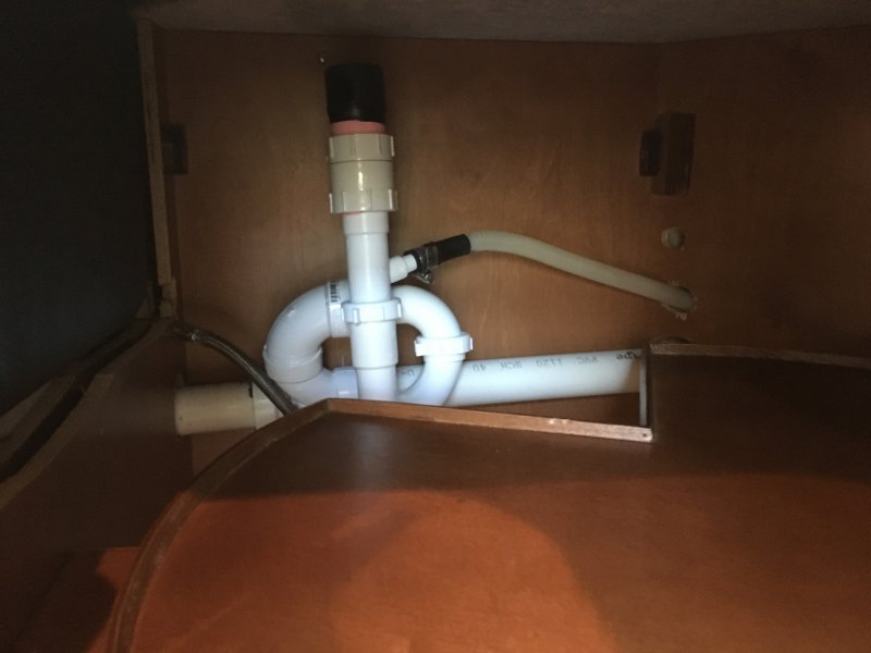

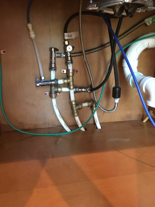

at a job today.
guess they didn't want to use a plumber. the drain is pitched the wrong way. a sanitary tee can't be used on its back, and it creates an s-trap.
i don't even want to talk about the supply side!
rottin'
Staff member
at a job today.
View attachment 53577 View attachment 53578
Only positive I can take away from this picture is that they at least used shark bite fittings...so thats progress. And easy to undo and re-set properly :)
