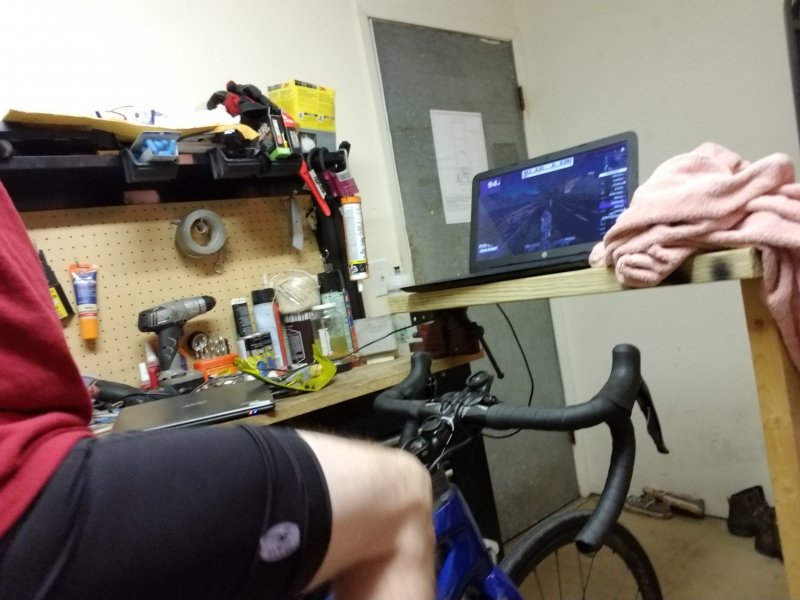

I just broke my trainer. The flywheel spins independently of the drive roller and I can't get it apart to see if there's a shear pin or something. I have to try to convince my wife that I have to get a new one and if that doesn't work I'm out.

I brought the trainer in to work so I could get a better look at it and I think that I might have fixed it. There's a setscrew on the roller that was loose and as soon as I cranked it down the roller grabbed the driveshaft. There seems to be some sort of bushing between the two that acts like a clutch. I'll find out tonight if that did the trick, if not then it looks like I have no choice but to learn to ride my rollers. Last time I tried that I put a hole in the drywall in my shop so I'll be sure to GoPro it if I go that route.
