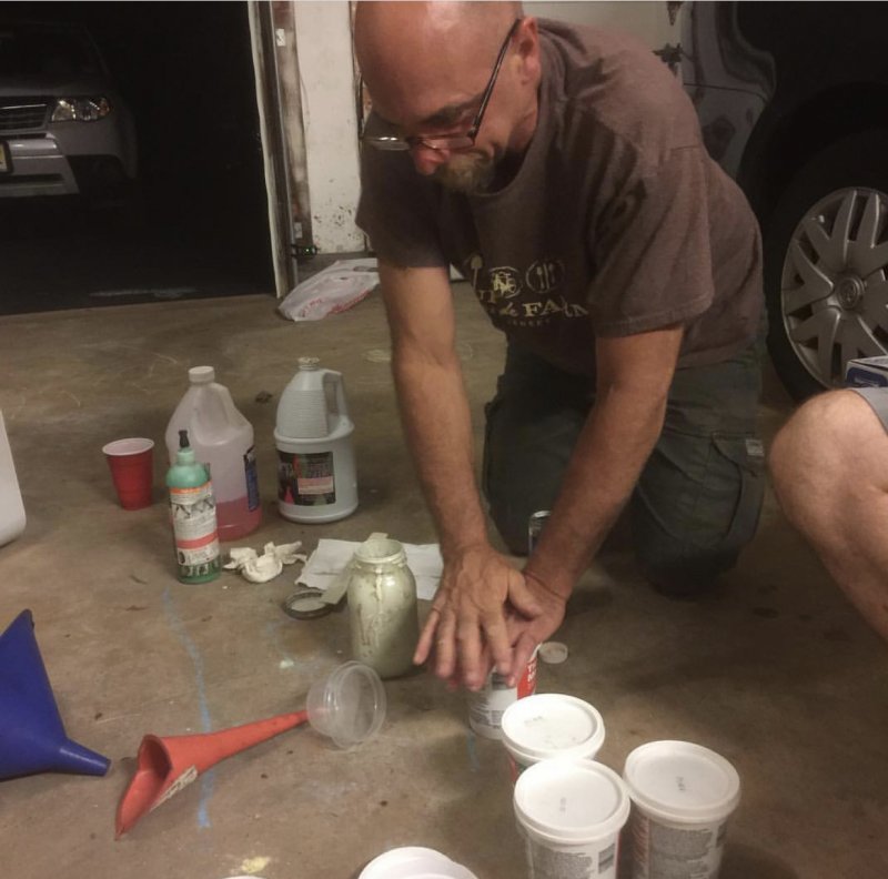

we made our own, and it works great for 1/3 the price.
@qclabrat - buy a gallon of liquid latex, mix it 1:1.5 with winter windshield fluid. So that is 2.5 gallons for $50.
oh, save some of the liquid latex for other stuff. ya never know.
think i got the latex from a make-up/costume shop.

Perhaps we ended up using RV antifreeze? Hey @clarkenstein, do you remember? Need something that is non toxic for obvious reasons
We split it 5 ways. It is a couple years old and what I have is still good. I had a bit more cause w didn't have enough PG. just keep it sealed, no air to react.
We didnt add glitter or any other grit. Seems like it would be a good idea for larger punctures.

Yep - I’m 99.9% sure we used RV stuff with latex.
Edit! Check it out @fidodie - my Instagram captured it. RV + latex + slime.

I've had mixed experiences with the DIY stuff. I've used this recipe. Used a tub of "mold maker". I don't know if real deal stans or orange would have sealed the punctures, but I'm not taking a chance with the DIY shit in my race wheels anymore.
