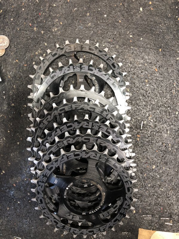

#15
I replace my chain (XX1 11sp) & chainring every ~ 500 miles. The Raceface rings I use are shot after 500 miles and the chain start to stretch. That way I can get 2000 mile out of the SRAM XX110-42 cassette ( the high cost item). The chain really does not stretch, the link get play in them. The only chain my son and I have ever broken has been KMC. Also the XX1 and XTR chains are much more corrosion resistance, and have never rusted on me.
