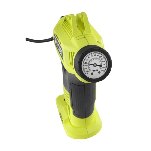

for tire filling, i have a ryobi battery op inflator cause i have the batteries...

That handheld ryobi can seat a tire? Interesting.

no - it can fill a tire, not seat it!!! wonky wording on my part.

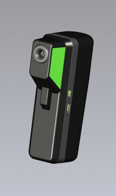

I guess I’ll drop some information on handheld rechargeable pumps spec to 120psi. I have been involved in development of a handheld unit. Should have one in my hands by December hoping that everything goes well. We already have some new ideas for V2 which will be even cooler but my friend is too far in to change. Not sure it will set a tubeless mtb. It’s been exciting to see this come to fruition through the months. I’ll drop a CAD file pic here. Will be just around 1lb and fit in your jersey pocket.
