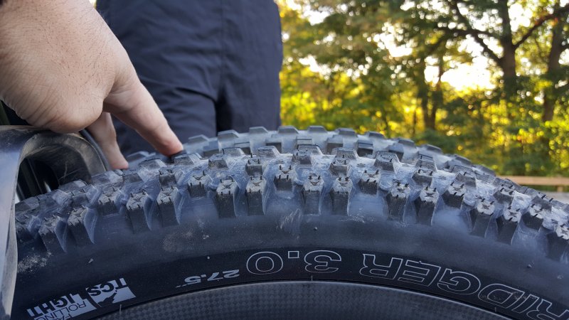

So today I finally picked up my specialized enduro 27.5 plus conversion from @jimvreeland, he did an awesome job setting everything up for me. Short breaknown of items purchased/needed for conversion;
-27.5 wheelset with 32mm inner width 38mm outer (any width over 25mm should be sufficient, although wider recommend )
-set of rotors
-new casette
-new tires (wtb bridgers ) tubless
Frame and fork is stock, rockshox pike 29er fork.
After I got the bike I took it straight lewis morris and gave it a test ride, first impressions are simply amazing, it was like riding a different bike, handling was spot on, the bike felt like it was glued to the trails, the semi large knobs of the bridgers bit right into the dirt but the large volume wrapped around all the roots like a glove, climbing was awesome, I didn't loose traction on the rocky uphills as I normally would with my Maxxis minions and the downhills were a lot more confident. Overall this was a great conversion and if anyone is thinking about it, I strongly recommend it, especially for beginners who want a little more confidence and traction.

Interesting, what's the clearance in the rear look like?
Yeh, jumpa pretty much summed it up with the .gif, hehe it was tighter then a German virgin but after some sandpaper magic, taking off the edge by jamming some 80 grit sandpaper between the rear triangle and tire seems to be fine but just to be on the safe side I ordered a wtb trailblazer 2.8 for the rear. Most of the rubbing noise turns out came from the chain slap protector that specialized installs on the rear triangle that was floating into the tires path, quick zip tie took care of that

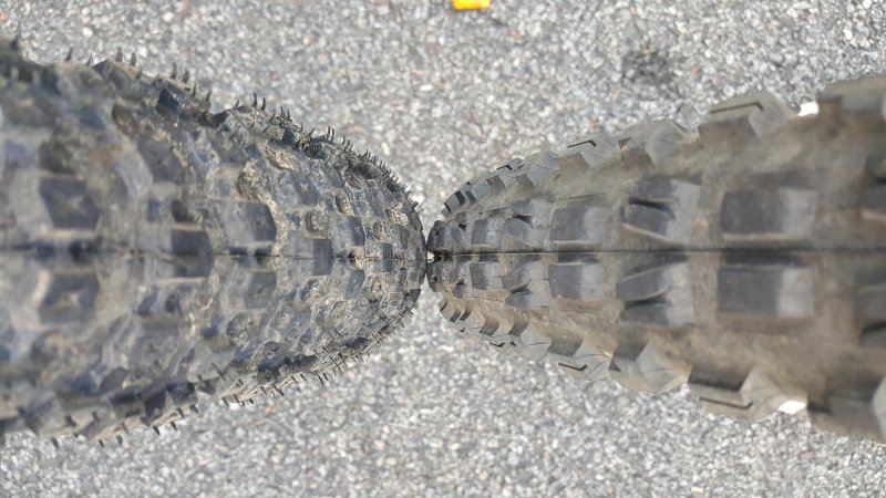

On the 2 tires side by side picture, are you comparing it with a Minion 2.50?
For some reason, I doubt that you were going faster on the uphills. My experience is that weight normally plays a far greater role on climbs than traction (unless you have to dismount). What you "feel" and the actual measured times can sometimes be wildly different. If you do Strava, I'd like to see your times compared to lighter tires. Not sure how much weight difference there is between Minion 2.5 and WTB 3.0.

I don't usually strava but I might start to see the two different wheelsets compared, I don't think there is a big weight difference in weight between both, @jimvreeland weighed the wtb 3.0 under a 1000g with packaging (don't know how much the minion 2.5's weigh. Both minions and wtb's are on carbon rims with comparable weights. The reason why I felt faster was because I always ride with jumpa at lewmo and he's always much faster but today I manged to stay pretty close on his tail both on climbs and descends. I don't necessarily think that it was weight or size of the tires, what I think attributed to the increased speeds on descends was the fact I felt much more confident with the grip and on climbs the tires made going over roots and rocks effortless as they wrapped around and never lost momentum or traction which in turn made the climbs smoother and more efficient. I'm not a racer so actual times mean nothing to me, the fact I feel confident to just point and shoot with a lot less hesitation makes all the difference which in turn I'm sure will make me an overall better rider.
